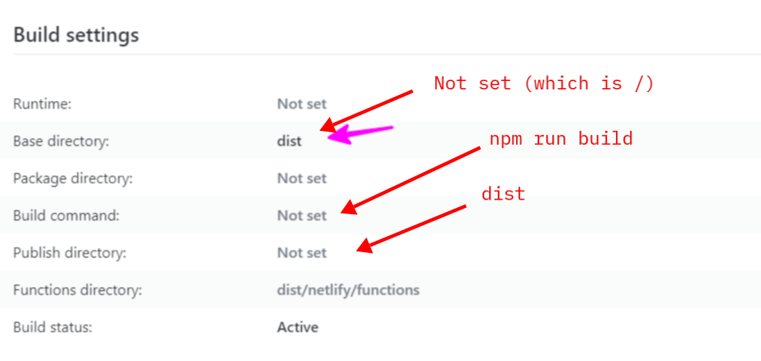

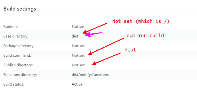

Good afternoon, it seems I solved the problem - I found a dependency that the base directory was not specified in my project - now I installed dist and everything seemed to work, in another project too. Dropbox - img-2024-03-07-10-51-58.png - Simplify your life

@krewe58 It’s not common to set your base directory as dist.
But if that works for how your project is set up, then great!
Checking your video above again, I can see you had files deployed inside a dist folder:

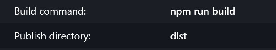

Usually the configuration would be more like this:
Which translates as:
  • Start at / and install the dependencies there
  • Run npm run build in that location
  • Publish only the files that are in dist
Good afternoon, I still don’t understand why this works, since the collector does not work with dist, it works with src. But it works.
I didn’t find any other dependencies, because otherwise the videos simply don’t get to netify
@krewe58 If you’re asking why having your Base directory set to dist works, without being able to see your repository I would say it’s because:
  1. Your repository contains a dist folder that already has the build output
  2. The Base directory of dist tells Netlify to do a cd dist
  3. There is no Build command so Netlify doesn’t run any build
  4. There is no Publish directory so Netlify deploys the files where it is (which is dist)
So your already built files in dist are deployed “as is”, and they’re deployed as the root of the site, since you deployed from within dist.
