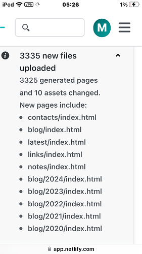

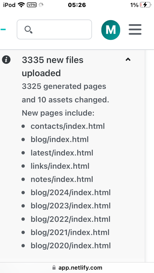

Why does the web UI say 3335 new files uploaded but then right afterwards it says 10 assets changed?
10 assets seems about right. If I add one blog post it will create updated index pages and the page of the actual post.
See screenshot.
The csv list thousands of files that haven’t changed. The Netlify UI even says only 10 assets changed. Why is it uploading all these files that didn’t change, doubling the deploy times?
The UI is showing 3325 files and 10 assets changed. You simply ignored (or missed) that line.

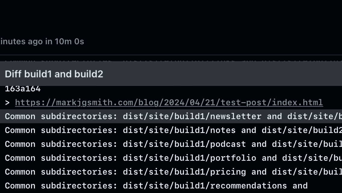

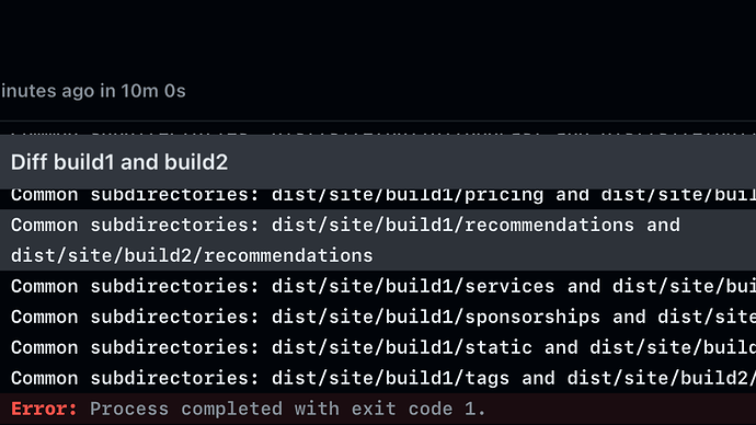

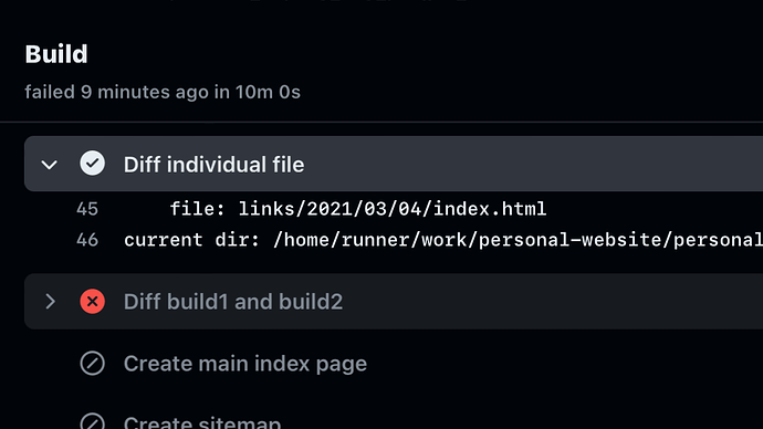

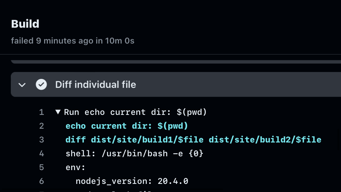

I ran the diff, first on an individual file listed in the csv you posted. There was no difference. See screenshots:

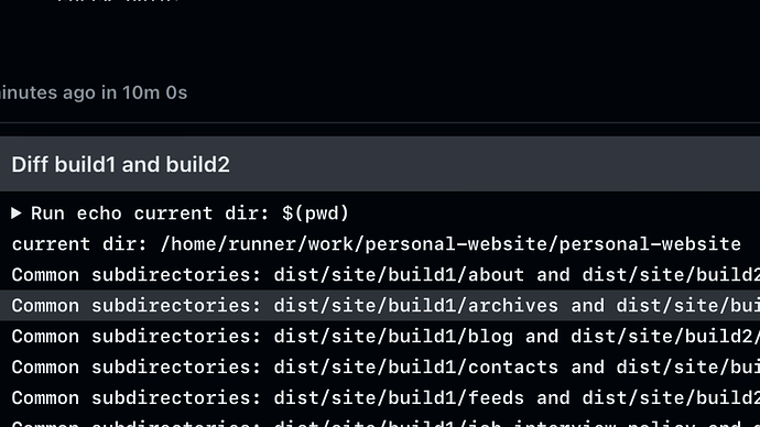

Then I ran the diff on the entire output directories from two successive builds. In between build1 and build2 I added a single blog post markdown file to the source data.
The diff listed 1 extra html file which was generated from the extra test markdown file. See screenshots:
So it appears to me that the diff is only finding the 1 extra file, not 3200 files.
The one caveat is that the diff command appears to have failed midway through. I can’t figure out the reason.
Is there a maximum number of files diff can handle?
What do you think is going on?
