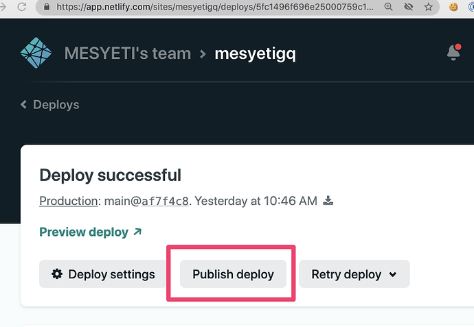

[Support Guide] I’ve deployed my site but I still see "Page not found”
You’ll want to debug in the way described at the top of this article, @MESYETI . I checked, and your current deploy has only a single file in it which is probably not what you intended - only readme.md is deployed. I suspect your build did not work as you expected, which is something you’ll have to debug.
In the meantime I’d recommend rolling back to a prior working deploy while you troubleshoot. You can use the button at the top of any successful build page to publish that older deploy, for instance this one: Netlify App
Edit: The website works now
yeah, the website was linked to the wrong GitHub repo, I fixed that and the problem still exists, I don’t understand the error, but I am very certain that index.html is there. Here is the failed deploy log.
