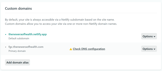

@adamlucero42 That looks good so far. Do you have the correct DNS settings on your theneweraofhealth.netlify.app site so that it knows what to do with this CNAME?
I’m not sure… Here’s what I have for that one.
@adamlucero42 This appears to be what’s causing the problem.

Hi, @adamlucero42, I checked both theneweraofhealth.com and www.theneweraofhealth.com just now and there was an SSL certificate issue for www.theneweraofhealth.com.
This was resolved with the “Renew certificate” button here:
Regarding the fgc subdomain, it was added to this site here:
If there are still issues with the fgc subdomain, do the the following steps in this order (the order is important):
  1. Delete the CNAME record here. (<- this appear to have already been done)
  2. Delete the name from the site you do not want it to point to under Site Name > Settings > Domain management > Custom domains.
  3. Add the domain name to the site you do want it to point to under Site Name > Settings > Domain management > Custom domains.
Once this is done, the subdomain will show the site it was added to in step three above.
