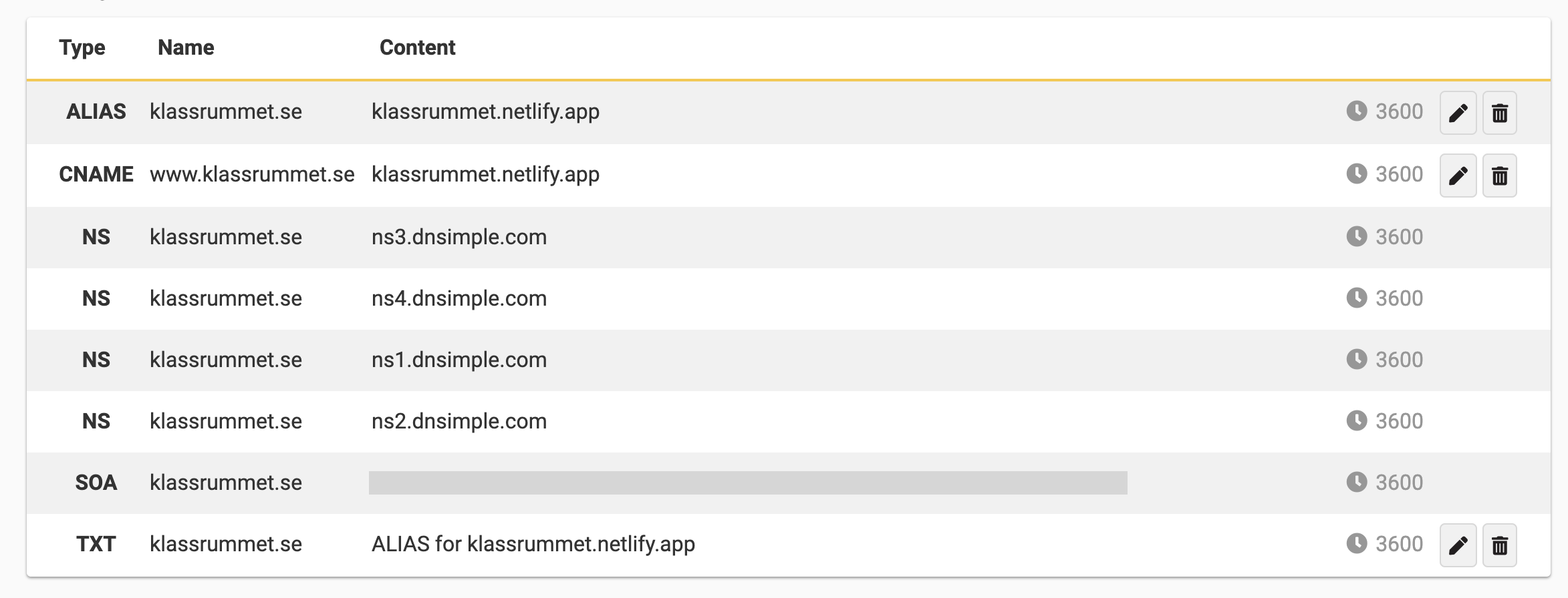

Thanks for looking into this for me. Here’s my DNS records, configured through DNSimple. I’ve compared them to the DNS records that I have set up for my other Netlify apps and they seem to follow the same structure. Is there a mistake in here that I’m not seeing?
Follow up: I reached out to DNSimple and we were able to reset the DNSSEC settings. 30 minutes later, Netlify accepted the change and the certificate was generated.
Many thanks for your help with identifying the root cause!
