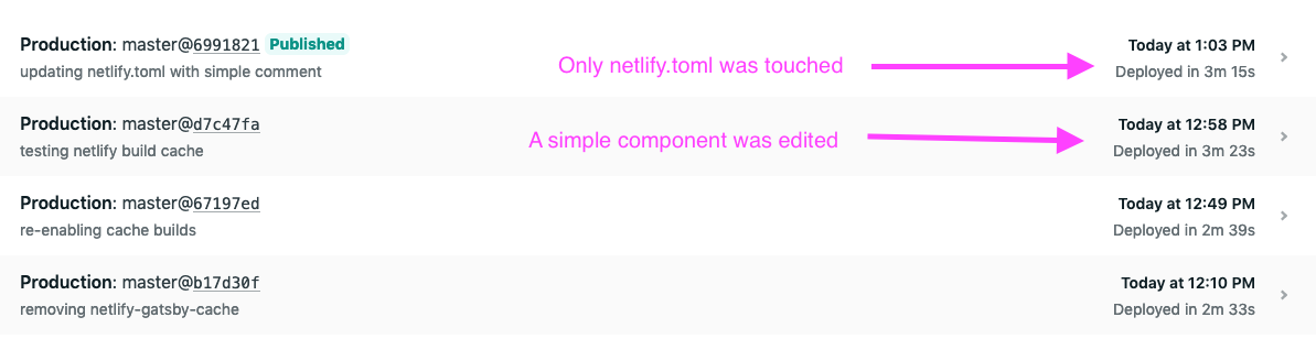

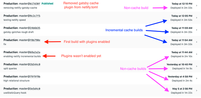

Netlify Plugins with netlify-plugin-gatsby-cache increases build time not reduce
Using netlify plugins with netlify-plugin-gatsby-cache increases build time rather than reducing. I followed your blog post and noticed my builds are now longer. I’m not using any CMS just building from a github repo.
As you can see, my builds are now taking over a minute longer and removing the plugin brings build time back down to normal level.

12:00:14 PM: Started restoring cached node modules
12:00:14 PM: Finished restoring cached node modules
12:00:14 PM: Started restoring cached yarn cache
12:00:14 PM: Finished restoring cached yarn cache
12:00:14 PM: Installing NPM modules using Yarn version 1.17.0
12:00:15 PM: yarn install v1.17.0
12:00:15 PM: [1/4] Resolving packages...
12:00:16 PM: [2/4] Fetching packages...
12:00:44 PM: info fsevents@2.1.3: The platform "linux" is incompatible with this module.
12:00:44 PM: info "fsevents@2.1.3" is an optional dependency and failed compatibility check. Excluding it from installation.
12:00:44 PM: info fsevents@1.2.9: The platform "linux" is incompatible with this module.
12:00:44 PM: info "fsevents@1.2.9" is an optional dependency and failed compatibility check. Excluding it from installation.
12:00:44 PM: info fsevents@2.1.2: The platform "linux" is incompatible with this module.
12:00:44 PM: info "fsevents@2.1.2" is an optional dependency and failed compatibility check. Excluding it from installation.
12:00:44 PM: [3/4] Linking dependencies...
12:00:44 PM: warning "gatsby > @typescript-eslint/eslint-plugin > tsutils@3.17.1" has unmet peer dependency "typescript@>=2.8.0 || >= 3.2.0-dev || >= 3.3.0-dev || >= 3.4.0-dev || >= 3.5.0-dev || >= 3.6.0-dev || >= 3.6.0-beta || >= 3.7.0-dev || >= 3.7.0-beta".
12:00:44 PM: warning "gatsby-plugin-netlify > webpack-assets-manifest@3.1.1" has unmet peer dependency "webpack@>=4.4.0".
12:01:01 PM: [4/4] Building fresh packages...
12:01:07 PM: Done in 51.78s.
12:01:07 PM: NPM modules installed using Yarn
12:01:07 PM: Started restoring cached go cache
12:01:07 PM: Finished restoring cached go cache
12:01:07 PM: go version go1.12 linux/amd64
12:01:07 PM: Installing missing commands
12:01:07 PM: Verify run directory
12:01:09 PM: ​
12:01:09 PM: β”Œβ”€β”€β”€β”€β”€β”€β”€β”€β”€β”€β”€β”€β”€β”€β”€β”€β”€β”€β”€β”€β”€β”€β”€β”€β”€β”€β”€β”€β”€β”
12:01:09 PM: β”‚        Netlify Build        β”‚
12:01:09 PM: β””β”€β”€β”€β”€β”€β”€β”€β”€β”€β”€β”€β”€β”€β”€β”€β”€β”€β”€β”€β”€β”€β”€β”€β”€β”€β”€β”€β”€β”€β”˜
12:01:09 PM: ​
12:01:09 PM: ❯ Version
12:01:09 PM:   @netlify/build 0.4.24
12:01:09 PM: ​
12:01:09 PM: ❯ Flags
12:01:09 PM:   mode: buildbot
12:01:09 PM: ​
12:01:09 PM: ❯ Current directory
12:01:09 PM:   /opt/build/repo
12:01:09 PM: ​
12:01:09 PM: ❯ Config file
12:01:09 PM:   /opt/build/repo/netlify.toml
12:01:09 PM: ​
12:01:09 PM: ❯ Context
12:01:09 PM:   production
12:01:09 PM: ​
12:01:09 PM: ❯ Installing plugins
12:01:09 PM:    - netlify-plugin-gatsby-cache
12:01:59 PM: ​
12:01:59 PM: ❯ Loading plugins
12:01:59 PM:    - netlify-plugin-gatsby-cache@0.2.1
12:01:59 PM: ​
12:01:59 PM: β”Œβ”€β”€β”€β”€β”€β”€β”€β”€β”€β”€β”€β”€β”€β”€β”€β”€β”€β”€β”€β”€β”€β”€β”€β”€β”€β”€β”€β”€β”€β”€β”€β”€β”€β”€β”€β”€β”€β”€β”€β”€β”€β”€β”€β”€β”€β”€β”€β”€β”€β”€β”€β”€β”€β”€β”€β”€β”
12:01:59 PM: β”‚ 1. onPreBuild command from netlify-plugin-gatsby-cache β”‚
12:01:59 PM: β””β”€β”€β”€β”€β”€β”€β”€β”€β”€β”€β”€β”€β”€β”€β”€β”€β”€β”€β”€β”€β”€β”€β”€β”€β”€β”€β”€β”€β”€β”€β”€β”€β”€β”€β”€β”€β”€β”€β”€β”€β”€β”€β”€β”€β”€β”€β”€β”€β”€β”€β”€β”€β”€β”€β”€β”€β”˜
12:01:59 PM: ​
12:01:59 PM: Found a Gatsby cache. We’re about to go FAST. ⚑️
12:01:59 PM: ​
12:01:59 PM: (netlify-plugin-gatsby-cache onPreBuild completed in 229ms)
12:01:59 PM: ​
12:01:59 PM: β”Œβ”€β”€β”€β”€β”€β”€β”€β”€β”€β”€β”€β”€β”€β”€β”€β”€β”€β”€β”€β”€β”€β”€β”€β”€β”€β”€β”€β”€β”€β”€β”€β”€β”€β”€β”€β”€β”
12:01:59 PM: β”‚ 2. build.command from netlify.toml β”‚
12:01:59 PM: β””β”€β”€β”€β”€β”€β”€β”€β”€β”€β”€β”€β”€β”€β”€β”€β”€β”€β”€β”€β”€β”€β”€β”€β”€β”€β”€β”€β”€β”€β”€β”€β”€β”€β”€β”€β”€β”˜
12:01:59 PM: ​
12:01:59 PM: $ gatsby build
12:02:01 PM:
12:02:01 PM: success open and validate gatsby-configs - 0.122s
12:02:02 PM:
12:02:02 PM: success load plugins - 0.903s
12:02:02 PM:
12:02:02 PM: success onPreInit - 0.002s
12:02:02 PM: success delete html and css files from previous builds - 0.022s
12:02:02 PM: success initialize cache - 0.005s
12:02:02 PM: success copy gatsby files - 0.042s
12:02:02 PM:
12:02:02 PM: success onPreBootstrap - 0.012s
12:02:02 PM: success createSchemaCustomization - 0.017s
12:02:03 PM: success source and transform nodes - 0.271s
12:02:03 PM:
12:02:03 PM: warning Plugin `gatsby-source-filesystem` tried to define built-in Gatsby GraphQL type `File`
12:02:03 PM:
12:02:03 PM:
12:02:03 PM:
12:02:03 PM: success building schema - 0.502s
12:02:03 PM:
12:02:03 PM:
12:02:03 PM: success createPages - 0.145s
12:02:03 PM: success createPagesStatefully - 0.111s
12:02:03 PM: success onPreExtractQueries - 0.000s
12:02:03 PM:
12:02:03 PM: success update schema - 0.042s
12:02:04 PM:
12:02:04 PM: success extract queries from components - 0.479s
12:02:04 PM:
12:02:04 PM: success write out requires - 0.004s
12:02:04 PM:
12:02:04 PM: success write out redirect data - 0.001s
12:02:04 PM:
12:02:04 PM: success Build manifest and related icons - 0.195s
12:02:04 PM:
12:02:04 PM: success onPostBootstrap - 0.197s
12:02:04 PM:
12:02:04 PM: β €
12:02:04 PM:
12:02:04 PM: info bootstrap finished - 4.953s
12:02:04 PM: β €
12:02:12 PM: Skipping purge because no template paths provided...
12:02:13 PM: warning Browserslist: caniuse-lite is outdated. Please run next command `yarn upgrade`
12:02:13 PM:
12:02:13 PM:
12:02:13 PM:
12:02:13 PM:
12:02:15 PM: Skipping purge because no template paths provided...
12:02:27 PM:
12:02:27 PM:
12:02:27 PM: gatsby-plugin-purgecss: Only processing  /opt/build/repo/src/styles/style.css
12:02:41 PM:
12:02:41 PM: success Building production JavaScript and CSS bundles - 37.223s
12:02:42 PM:
12:02:42 PM: success run queries - 38.017s - 24/24 0.63/s
12:02:42 PM:
12:02:42 PM:
12:02:42 PM: gatsby-plugin-purgecss:
12:02:42 PM:  Previous CSS Size: 2359.40 KB
12:02:42 PM:
12:02:42 PM:  New CSS Size: 32.11 KB (-98.64%)
12:02:42 PM:
12:02:42 PM:  Removed ~2327.30 KB of CSS
12:02:42 PM:
12:02:42 PM:
12:02:47 PM:
12:02:47 PM: success Building static HTML for pages - 5.164s - 29/29 5.62/s
12:02:47 PM:
12:02:47 PM:
12:02:47 PM: success onPostBuild - 0.033s
12:02:47 PM:
12:02:47 PM: info Done building in 48.261 sec
12:02:48 PM: ​
12:02:48 PM: (build.command completed in 48.5s)
12:02:48 PM: ​
12:02:48 PM: β”Œβ”€β”€β”€β”€β”€β”€β”€β”€β”€β”€β”€β”€β”€β”€β”€β”€β”€β”€β”€β”€β”€β”€β”€β”€β”€β”€β”€β”€β”€β”€β”€β”€β”€β”€β”€β”€β”€β”€β”€β”€β”€β”€β”€β”€β”€β”€β”€β”€β”€β”€β”€β”€β”€β”€β”€β”€β”€β”
12:02:48 PM: β”‚ 3. onPostBuild command from netlify-plugin-gatsby-cache β”‚
12:02:48 PM: β””β”€β”€β”€β”€β”€β”€β”€β”€β”€β”€β”€β”€β”€β”€β”€β”€β”€β”€β”€β”€β”€β”€β”€β”€β”€β”€β”€β”€β”€β”€β”€β”€β”€β”€β”€β”€β”€β”€β”€β”€β”€β”€β”€β”€β”€β”€β”€β”€β”€β”€β”€β”€β”€β”€β”€β”€β”€β”˜
12:02:48 PM: ​
12:02:48 PM: Stored the Gatsby cache to speed up future builds.
12:02:48 PM: ​
12:02:48 PM: (netlify-plugin-gatsby-cache onPostBuild completed in 344ms)
12:02:48 PM: ​
12:02:48 PM: β”Œβ”€β”€β”€β”€β”€β”€β”€β”€β”€β”€β”€β”€β”€β”€β”€β”€β”€β”€β”€β”€β”€β”€β”€β”€β”€β”€β”€β”€β”€β”
12:02:48 PM: β”‚   Netlify Build Complete    β”‚
12:02:48 PM: β””β”€β”€β”€β”€β”€β”€β”€β”€β”€β”€β”€β”€β”€β”€β”€β”€β”€β”€β”€β”€β”€β”€β”€β”€β”€β”€β”€β”€β”€β”˜
12:02:48 PM: ​
12:02:48 PM: (Netlify Build completed in 1m 39.3s)
12:02:48 PM: Caching artifacts
12:02:48 PM: Started saving node modules
12:02:48 PM: Finished saving node modules
12:02:48 PM: Started saving yarn cache
12:02:48 PM: Finished saving yarn cache
12:02:48 PM: Started saving pip cache
12:03:01 PM: Finished saving pip cache
12:03:01 PM: Started saving emacs cask dependencies
12:03:01 PM: Finished saving emacs cask dependencies
12:03:01 PM: Started saving maven dependencies
12:03:01 PM: Finished saving maven dependencies
12:03:01 PM: Started saving boot dependencies
12:03:01 PM: Finished saving boot dependencies
12:03:01 PM: Started saving go dependencies
12:03:01 PM: Finished saving go dependencies
12:03:01 PM: Build script success
12:03:01 PM: Starting to deploy site from 'public'
12:03:01 PM: Creating deploy tree
12:03:01 PM: Creating deploy upload records
12:03:01 PM: 0 new files to upload
12:03:01 PM: 0 new functions to upload
12:03:01 PM: Starting post processing
12:03:03 PM: Post processing done
12:03:04 PM: Site is live
12:03:57 PM: Finished processing build request in 4m14.168552238s
Notice the plugin appears to install every time which is taking over a minute to do so. Is there a way to get the plugin to be cached?
I noticed that builds were using the command gatsby build rather than npm run build which has the needed environment variable. Made that change, re tested, and still get longer builds

Thanks for this report! Our Build Plugins team is discussing this issue here:
I’ve added your post there :+1:
Thanks for that link.
I added the plugin to my package.json and that appears to fix the issue they are referring to.
I would suggest updating your docs (or at least that blog post) until you have a permanent fix. You’ll probably have a lot more of these threads otherwise
I was having the same issue, thanks for the detailed breakdown @randallmlough. Fix worked for me as well (average time down from 3.30s to <1.4sec so far, much closer to pre-cache build times).
For anyone else a little unsure on how to β€œadd to package.json” just install the package via yarn or npm. For instance with yarn:
yarn add netlify-plugin-gatsby-cache
I saw immediate improvements in build time.
Hey there! I just added information to the other entry. @randallmlough’s breakdown is excellent, so I’m only adding this for additional context.
