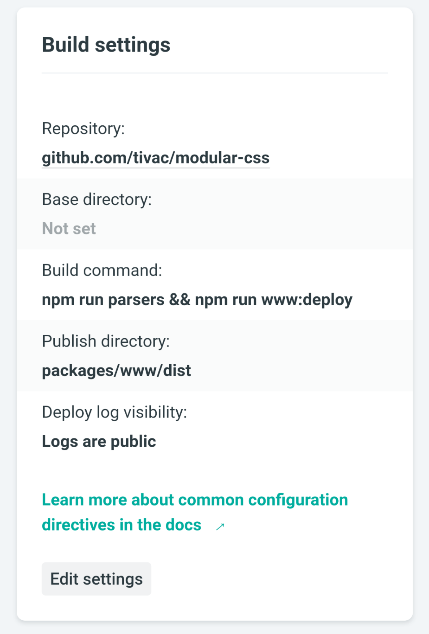

Here’s my current build settings.

Thanks. Is it installing that dev dependency in a separate directory other than your root node_modules? I ask because we only cache the single node_modules directory so any dependencies that live in other directories won’t be cached.
Yup, that explains it. I can bring all those dependencies up to the root but that’s pretty gnarly.
Could I instead change my “Build command” to run npm i before it tries to assembled the website?
The answer seems to be “yes I can”.
That’s… gross but workable I guess. Thanks for the help diagnosing this @futuregerald, I don’t think I ever noticed anything in the docs about the node_modules caching being only at the root so I likely would’ve never been able to track this down.
